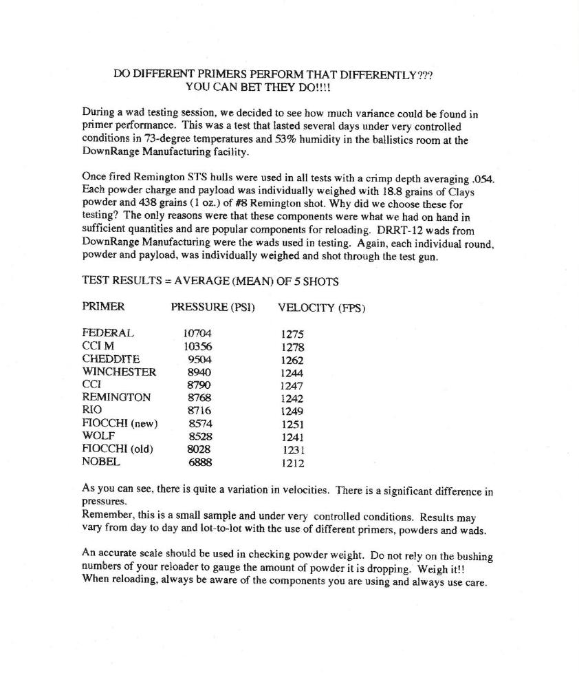

    Very interesting small test by Down Range Manufacturing on Primers and their wads. From Down range Manufacturing.  Primers.jpg

    it would be interesting to see it translated on a chart, just how much it effects the 'shot on target' at certain distances.
    otherwise, in all the decades of shooting, i have never seen a substantial difference actually shooting, at all.
  3. MDavid
    MDavid Mega Poster
    Where did you find this? The results indicate to me that test with the Nobel Sport primer was with the old 686 prmier, not the 688. Nobel Sport claims that the new 688 is exactly the same as the Cheddite.
  4. MDavid
    MDavid Mega Poster
    btw, I have used both the 686 and the 688 Nobel Sports and could understand those results with the 686, but since the 686 is discontinued it makes no sense to even test those primers. I reload 410 only and the NS 688 performs no different than the Win209. I have emailed Downrange for some clarification.

    For those that want to know, this is the response from Downrange regarding the Nobel Sport primers used in this test:
    "These would have been with the 686 primer.
    Kevin
    On Sun, Apr 9, 2023, 11:18 AM Mark wrote:
    Dear Sir,
    I'm curious about the results of tests done at your facility regarding how different primers perform(see attached). For the test with the Nobel Sport primer, were these done with the older 686 or the newer 688 primer? Nobel Sport claims that the new 688 primer is very close, if not the same, as the Cheddite primer, so I was surprised to see such a difference in your tests. I appreciate your response.
    Sincerely,
    Mark"
