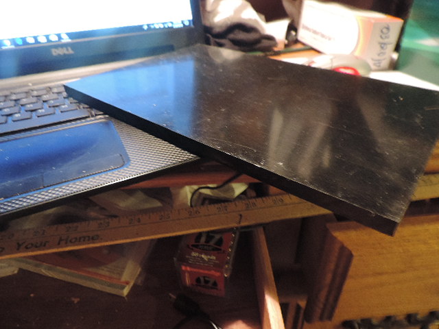

    Here is the red dot scope I ordered, should be here next week. It's a Burris paralex free with no obstrutions around lens to enterfer with picking up of target. Plus I'm a two eyed shooter anyway.
    I'll design a cantalever style post mount for the sight probably around 10 to 12'' hi. depending on location on barrel.
    Now only if that dang limb did not fall from tree when i was cutting fire wood and damaged my spinal cord. red dot.PNG

    ROOKIE SHTR: Make your mount out of Aluminum Stock, I made one and shot it at Missouri Hdcp, I sold the mount and site to The Owner of Wenigs.
    GB............................DLS

  18. dr.longshot
    That delron is not Stable enough or strong enough for that Site Installation. Mine was made out of Aluminum, and mounted under the Adj Comb to the stock.
    Just being helpful here, been there Done That.
    rookieshooter likes this.

  74. mudpack
    You probably mean Delrin?
    I wouldn't....not rigid enough.
  75. rookieshooter
    Cleaned up the scope mount by cutting off extra mounting rail. Drilled and tap for another socket screw. This will make it lighter also. Now to do same on the Rem 1100, aka ''The Hip-O-Matic''.
