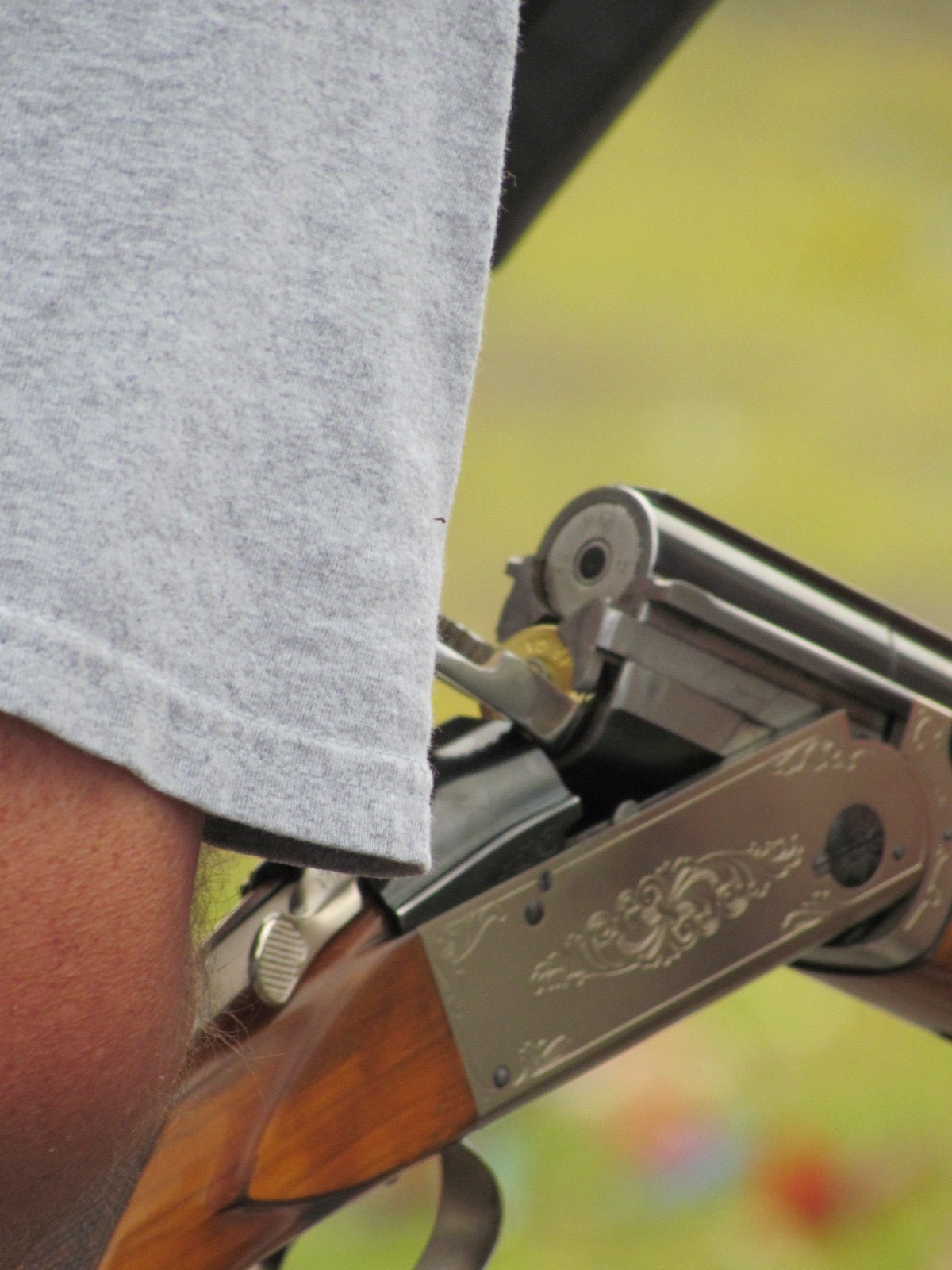

    Wouldn't it be faster and easier to just take the barrel off and tap out the ejector?
  3. ljutic329
    Must not know how the ejector system functions
  4. oleolliedawg
    Then they'd probably lose the detent ball and spring and spend even more time searching for 'em. The blind leading the blind.

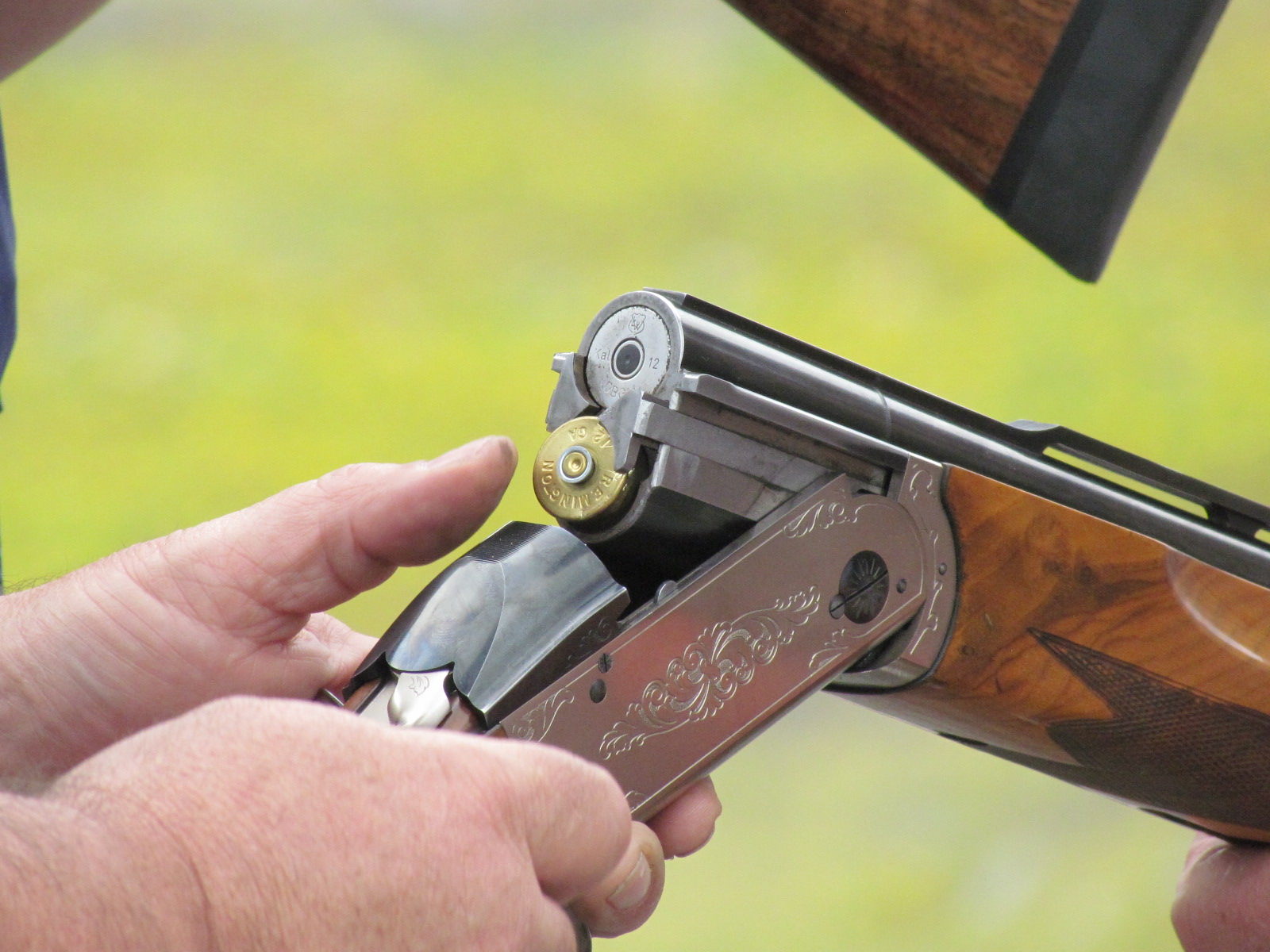

  5. Flyersarebest
    I've seen it before on other guns. My Citori a few times and twice in 20+ years with my old type 3 MX8 so it's not something that rare. My first question when I saw the picture was, what's the deal with the primer? When I had it happen to me the rim was under the ejector but the primer was still seated.
    What made it back out of the case?
  6. robb
    robb Well-Known Member
    We used to have that using Blue Magic’s and AA primers. And that’s not a Remington primer. Looks like AA.
  7. mallard2
    mallard2 Active Member
    Just pop out the ejector. Remove shell. Replace ejector. 3 -4 min.
  8. wpt
    Got to be re pops (reloads) and one thing for sure is they need a much bigger hammer ... He has the shell in upside down also ... Supposed to say Remington across the top not on the bottom like he has it ... ... WPT ... (YAC) ...
  9. Jersey Giant
    Jersey Giant Active Member
    The primer thing has me baffled. How can a primer back out?
  10. wpt
    The primer will back out if the primer hole is to big and it does not fit in tight enough … I am not a fan of reloading but have seen many people open the gun and primer, brass etc go flying … They need to put arrows on them so they do not get put in upside down …. WPT … (YAC) …

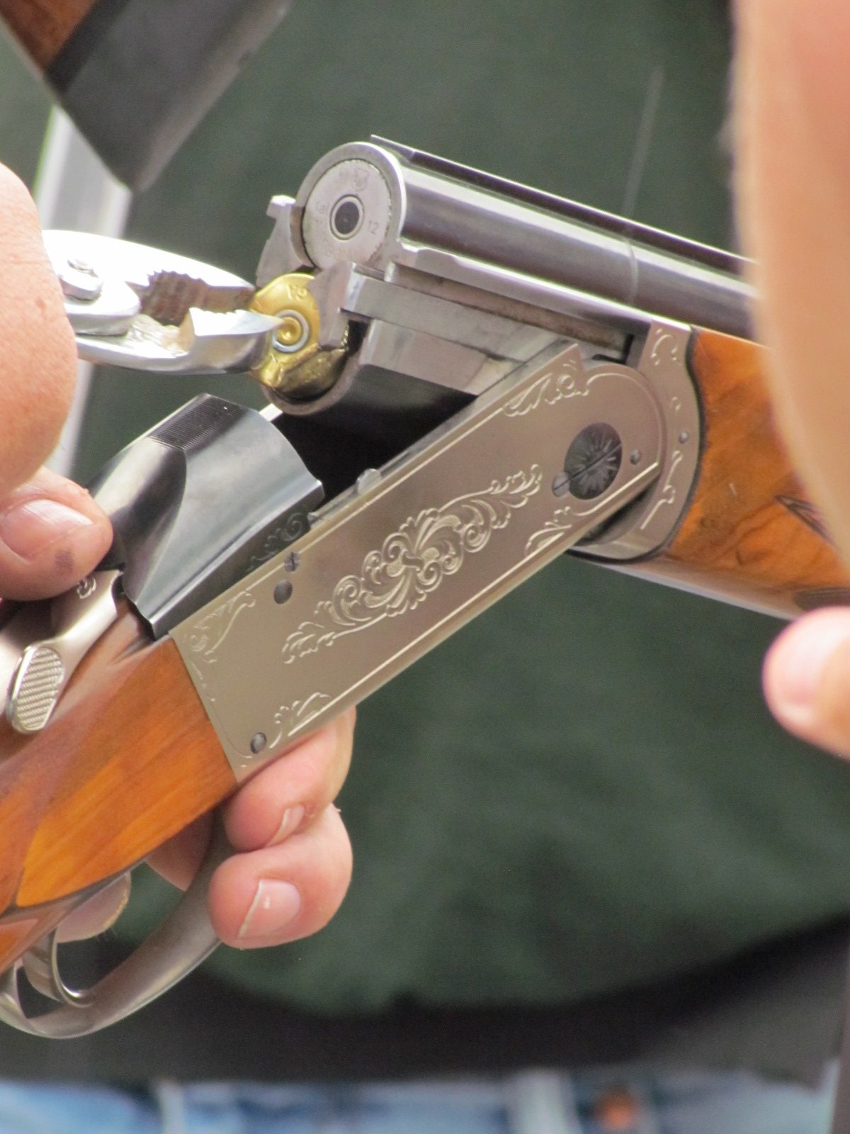

    Not familiar with a Kriegoff but on a Perazzi the ejector has to be in flush with the receiver before you can remove the locking piece. K gun different?
  20. jansonuhl
    jansonuhl jansonuhl
    If clearances are right it will not go past the ejector coming out without the possibility of bending or breaking the ejector. See post #18 for easy solution.
