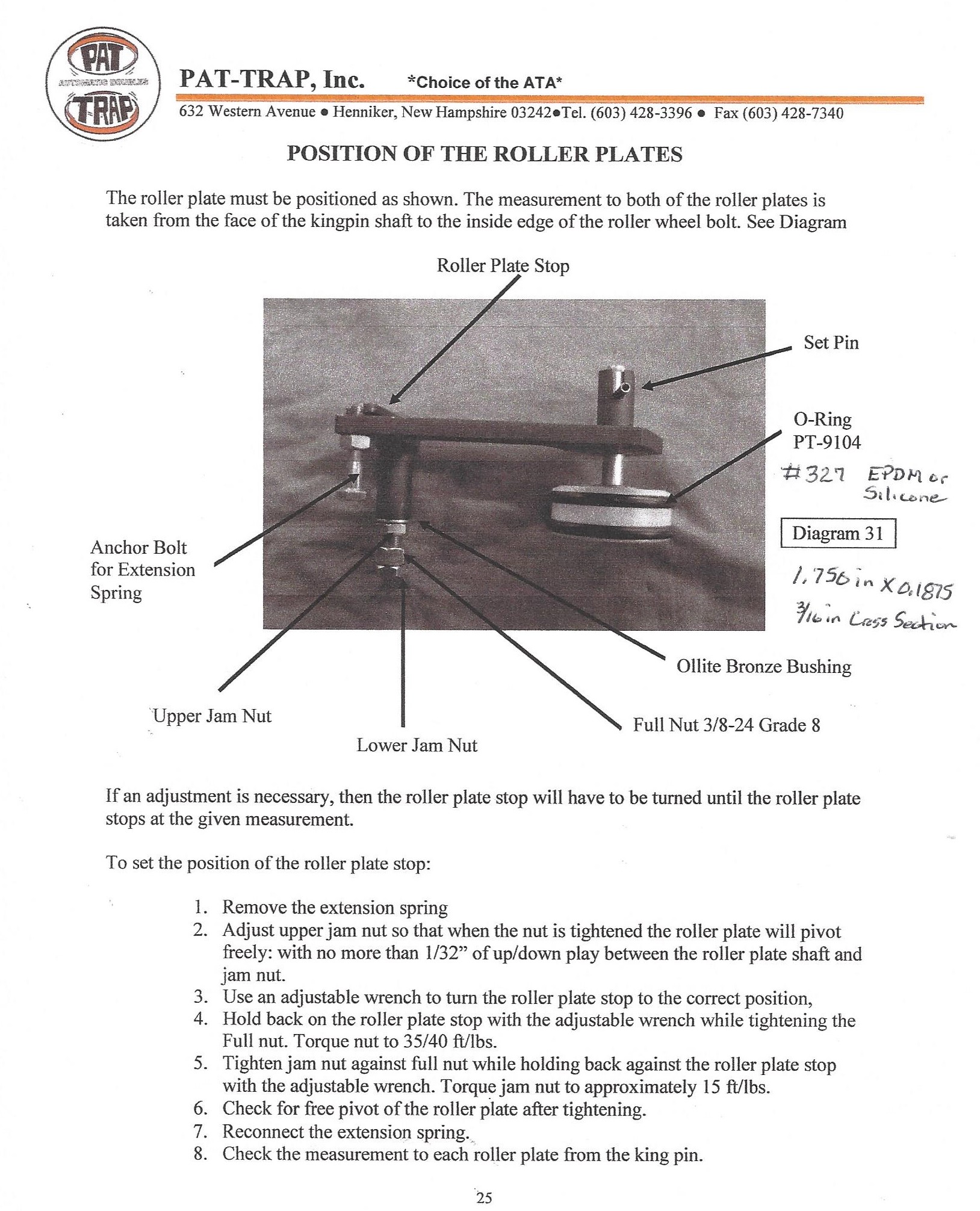

    What is the size or -# of the o-ring that goes on the wheels that rides against the targets?

    Here's what I have on file. You should verify yourself since I don't have much time working on PAT Traps and I don't recall who provided the information to me.

    Thanks for the help and response. Will verify and make sure that nothing special is going on. You guys are great!!!!!

    You should be able to get them at any auto supply store. Roger C.
  12. wpt
    Ace or True Value have drawers full of them all different sizes … I had to get some for the fuel regulator on my Hot Rod … $28.00 from Summit Racing. $1.59 each at Ace ... WPT … (YAC) …

    Order them online from McMaster Carr. I use them all the time for work. Most deliveries are overnight.
