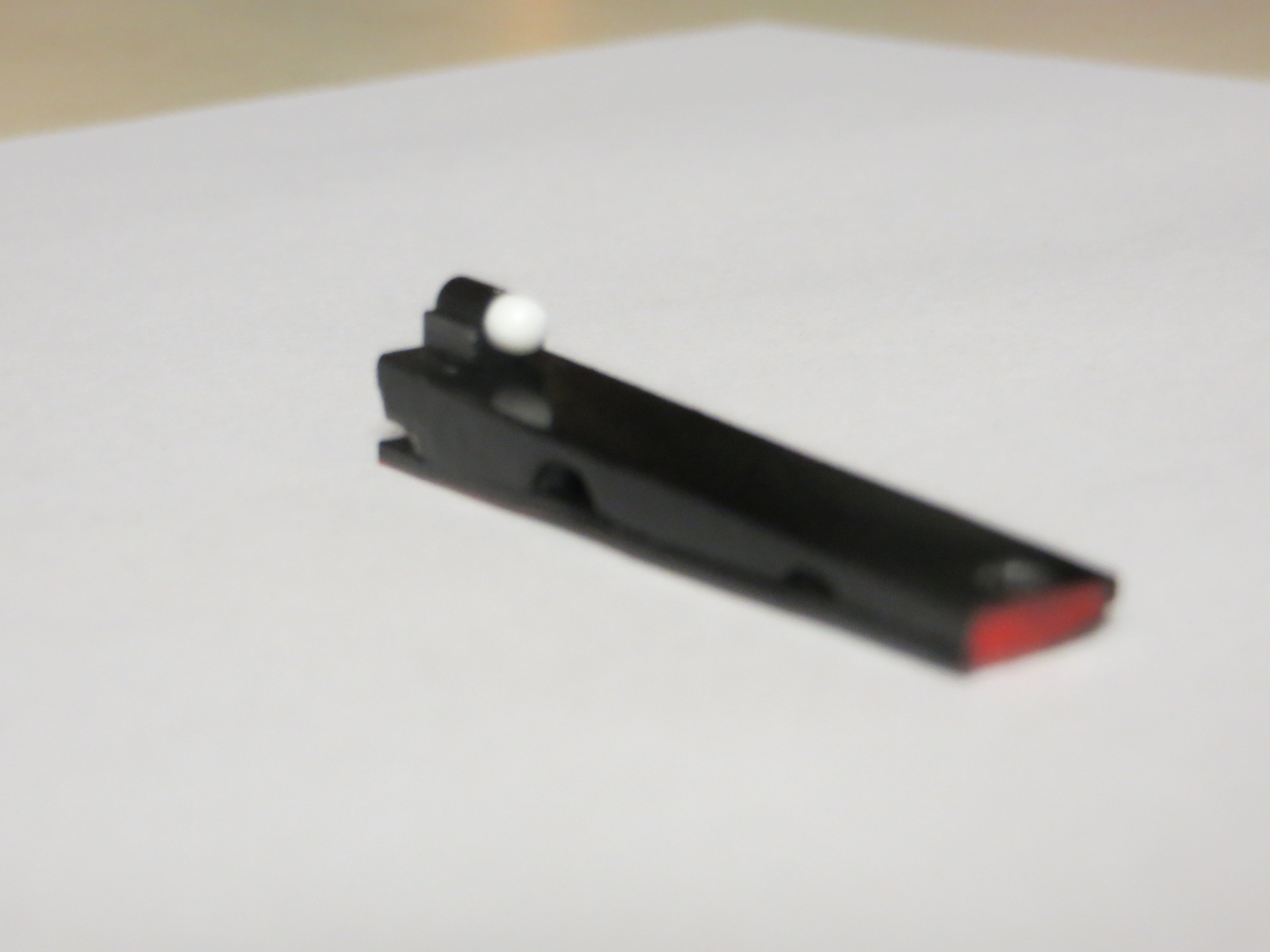

  13. rrisum
    rrisum Mega Poster
    If my memory is correct - or check it out on Rolin Oswalts stock fitters bible -1/8 inch raise on the front bead, on a 3/4 ' barrel will lower you POI 3" -You will have to check it out - this is what I have done to several hunting guns to lower their POI - Works good - held on with two sided auto tape IMG_0570.JPG
    cl3 and Storeman like this.

  26. Shooter-007
    Shooter-007 Well-Known Member
    This or a big bead can work beautifully to raise POI
