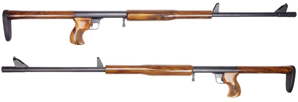

  20. N1H1
    N1H1 Mega Poster Founding Member
    Here's what you must be talking about, Bama, but it's not the one I am thinking about.
    Of course, I've never seen one like this - Who has? - and may have mixed up what I thought I saw in the magazine.
    N1H1

  31. BAMA
    BAMA Mega Poster
    Actually, the picture you've shown is the wrong one (triangle). The triangular sight I had was infact a three bar tringle about 2.5" to a side and it was adjustable side to side and up and down. There was no secondary sight to the rear. I've never seen another one like it. The one you showed is the same one I had on my second Spacegun. Which I replaced with an adjustable short rib.
